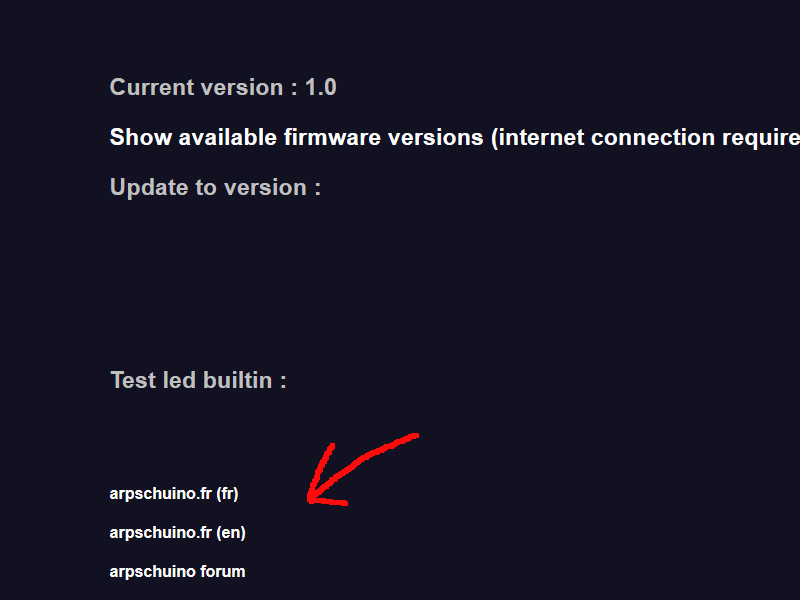

What happens when you click on the links at the bottom of the page?

When I click the links, they take me to the website or the forum.
